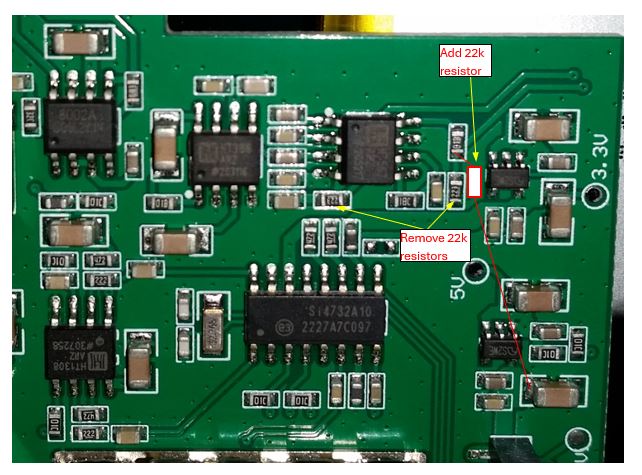

Looking at an image I found elsewhere, I think the power connections to the DIGI decoder ICs and associated components can be isolated with two cuts on the bottom side of the PCB. A strap would be required as shown to reconnect the switched battery voltage to the LDO regulators. A charge pump would then need to be added to power the isolated DIGI decoder section.
Care would need to be taken with any modifications on the bottom side of the PCB since it sits on top of the battery.
There may be other possible modifications, such as replacing the switched battery feed with the output of a medium power 5V boost regulator. This would be quite simple, but means there will be more switching noise, which may cause interference on the radio side.
If your ATS25 AMP is working, I would leave it and recharge the battery as required if there is a problem.

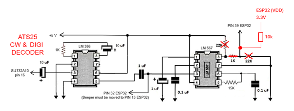

An observation on the DIGI decoder circuit is that the low voltage failure in CW/RTTY mode may be due to the voltage levels presented to the ESP32.
The output of the LM567 (Pin 8) is open collector, so the logic high level is set by the resistors. The values are such that the voltage at the ESP32 does not exceed 3.3V with a DIGI decoder supply voltage of 5V.
The logic high level presented to the ESP32 will be approximately 0.49 x 5V = 2.45V.
In the case of the ATS25-AMP, the VCC to the DIGI decoder is Vbatt and so as the battery voltage falls, the VIH requirement on the ESP32 will not be met.
Although the circuit failure may also be due to the low voltage to the LM386 and LM567, I am not sure why the pull-up on the output of the LM567 is not connected to VDD (3.3V) of the ESP32, which would guarantee the correct levels without any risk of the input being over driven (example below).

Could you show us a before and after pictures so I know what to add and remove.
ATS25 AMP mistake update
I have not made this change to my ATS-25 AMP, it was an observation after looking at the circuit diagram of the DIGI decoder.
It may be the case that without increasing the VCC to the LM386 and LM567, the circuit will still not behave correctly.
The change could be simplified without shorting out the 1kΩ resistor.
As stated previously, if your ATS25-AMP is working, I would not make any modifications.
