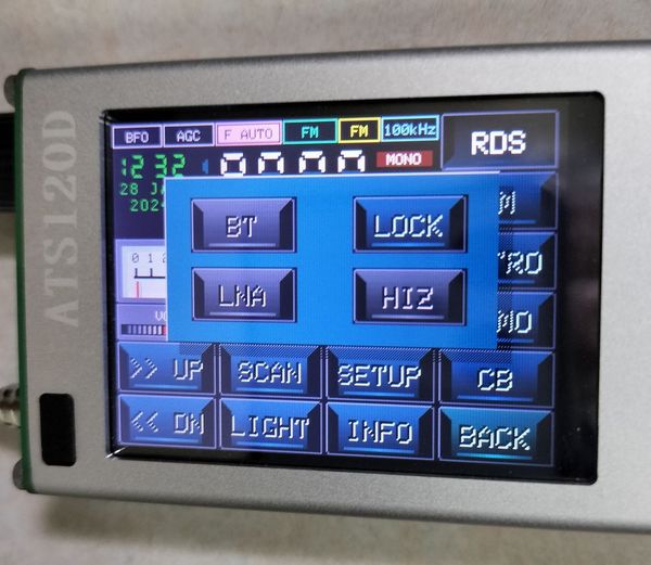

Hi.
I purchased ATS-120D and updated the firmware to 4.17Air b since there is no WIFI.
Then I could use WIFI, but LNA and Bluetooth became completely unusable.
I'm in trouble! Please give me advice.
The original firmware was 5.2b_Dark with LNA and Bluetooth enabled.
ATS-120
kazu118, You should install the ATS120 version
kazu118
Зарегистрирован: 20 янв 2024, 15:12
ATS-120
Сообщение kazu118 »
After editing setting.ini and updating the firmware, the problem was resolved.
thank you.
