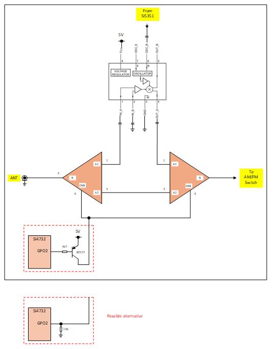

The scheme has an error, pins 1 and 4 on the BL1551B chip have been replaced.

Yes, I agree that the previous schematic shown looks incorrect.
From the layout information (Ref: https://github.com/IU4ALH/IU4ALH/tree/main/PCB's), the BL1551B switches appear to be connected as shown in the diagram below. The RF switches appear to be connected correctly, but I have some doubt about the control circuit. See further notes below.
1. GPO1 and GPO2 signals.

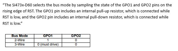

Care needs to be taken when using GPO1 and GPO2, since these pins are sampled at power up to determine the bus mode for the control interface.
An extract from the datasheet is shown below. Some hardware implementations (e.g. ATS25-AMP) also have external resistors on the GPO1 and GPO2 signals to ensure the correct levels are detected at start-up.
GPO1 10kΩ pull-up to 3V3.
GPO2 10kΩ pull-down to GND.
2. PNP transistor on GPO2
The proposed circuit may not work correctly since it may corrupt the startup value for GPO2 and there is no load resistor on the collector of the transistor.
The control state for selecting the mixer will be opposite to that shown on the diagram from Binns. GPO2 = 0 = Mixer bypass.
GPO2 = 1 = Mixer enabled.
The logic thresholds for the BL1551B ENB input are TTL compatible, so it should be possible to drive it directly from GPO2 of the SI4732 (possible alternative).

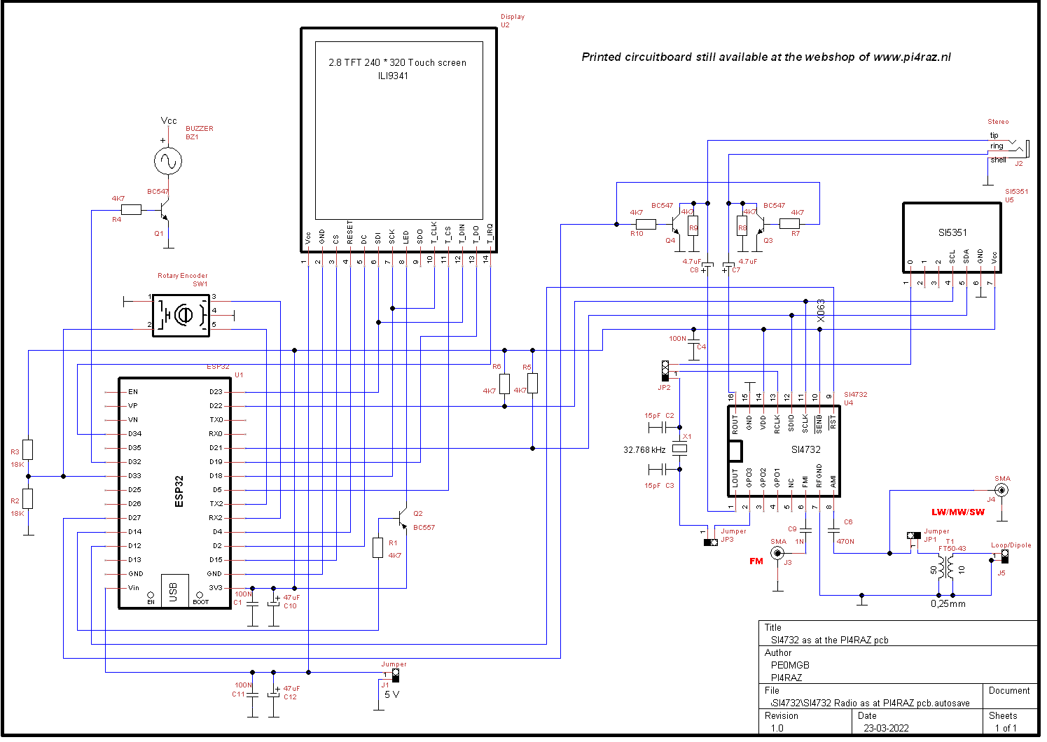

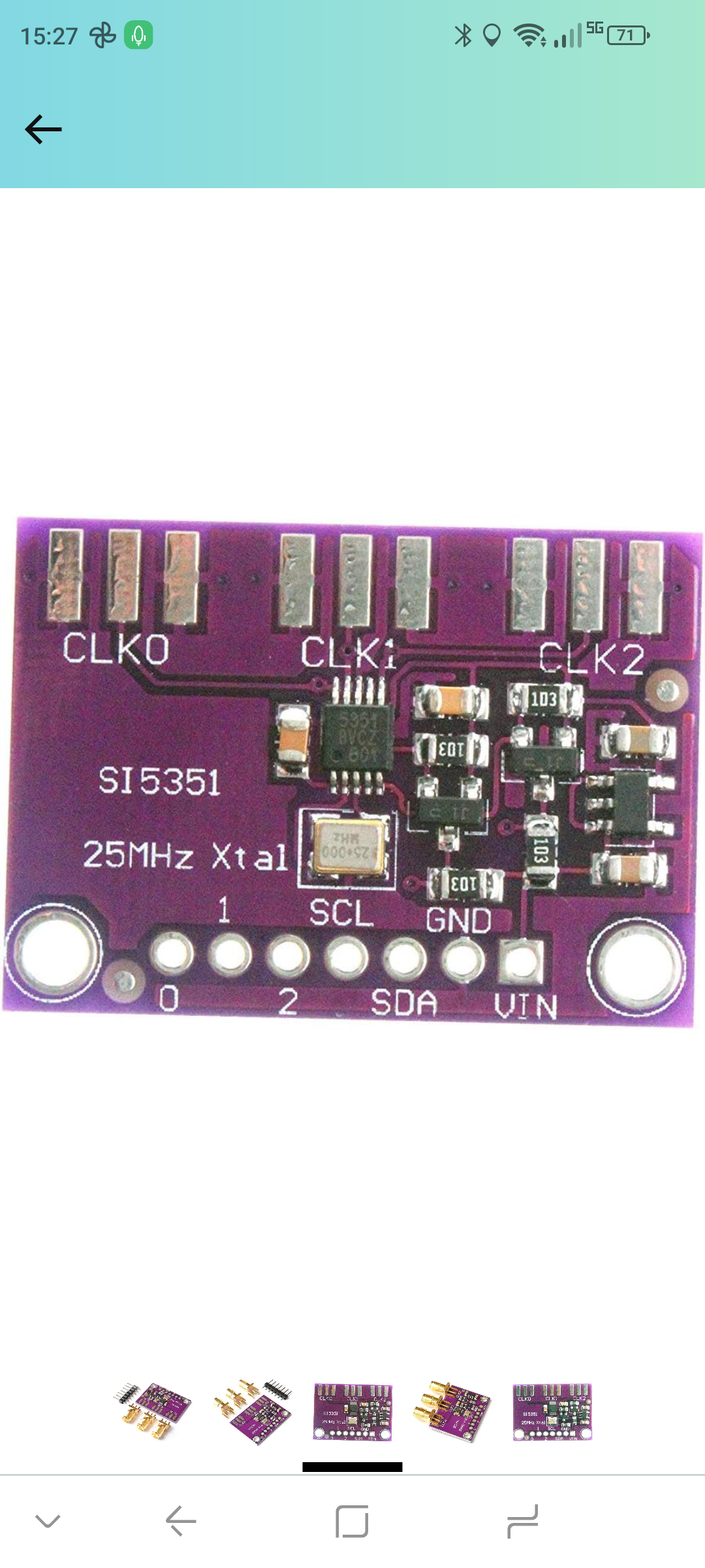

Hello G8ptn, thanks for the information provided. I thought it could be connected as shown in the image and to connect the JP2 using a manual switch. to expand the band.

У меня есть такой же модуль, как на картинке уважаемого Darwin (download/file.php?id=161&mode=view).
Если мне не нужно расширение диапазона, а нужны только стабильность и точность установки частоты, можно ли использовать схему из его же поста выше ⇈ без всякого микшера NE602? Дивайс ATS25 max-Decoder II

Yes, if you only want the frequency stability feature, you do not need the NE602 mixer and its associated circuitry.

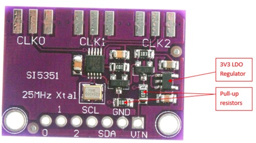

The SI5351 module shown in the link has an on-board 3V3 regulator. It should work with 3V3 (VIN), but some of the forums show it powered with 5V with the pull-up resistors on the SCL and SDA pins removed (see attached).

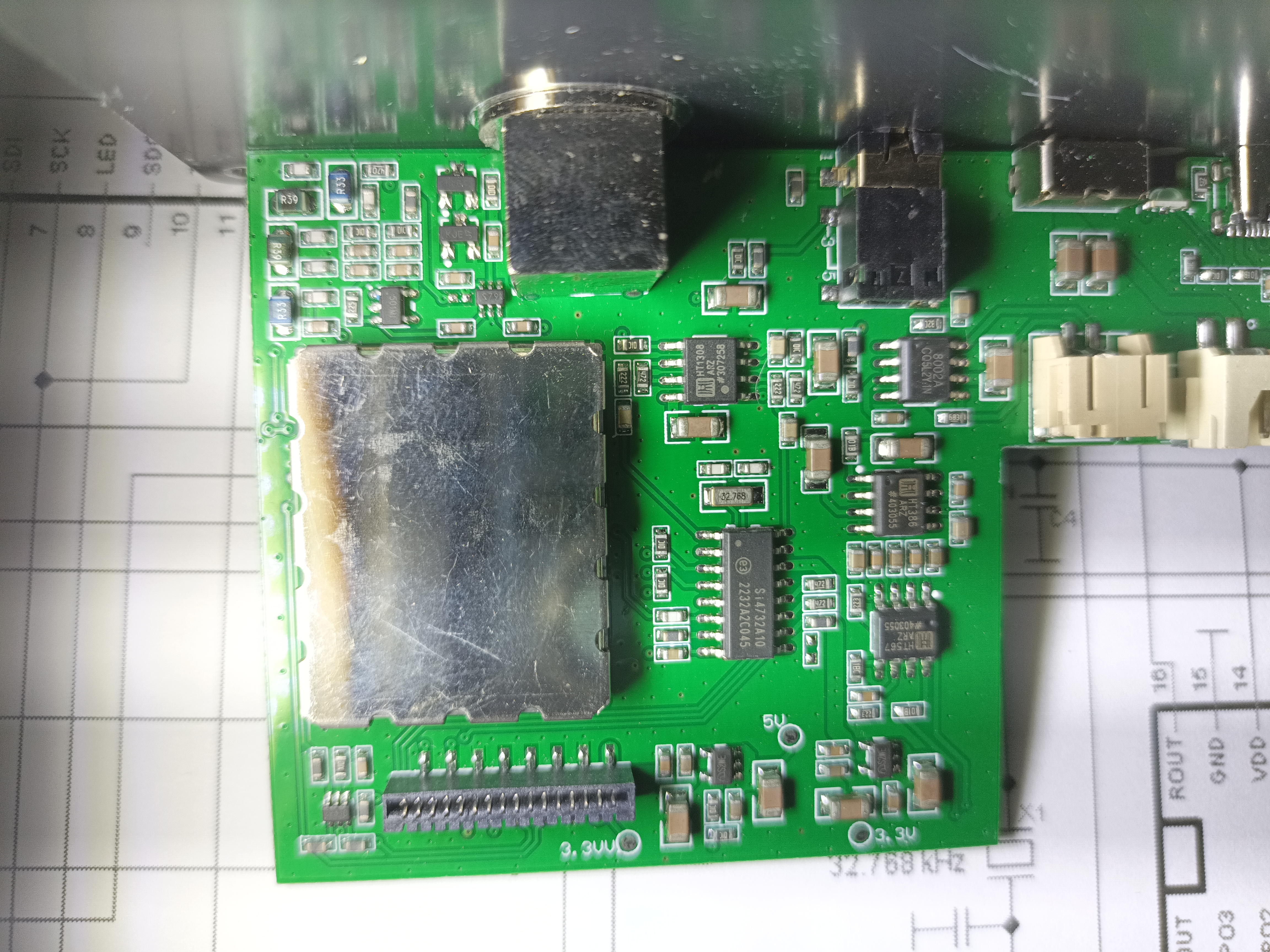

Spoiler, не можете ли вы выложить фото как внутри Max Decodera ll расположен и подключен блютуз передатчик.

Спасибо, Dave(?), Вы как всегда конкретны и лаконичны. А я вот не догадался погуглить насчёт питания... А что это за чип там в качестве стабилизатора (на нём написано что-то вроде LG33)? Может, лучше его обойти?

Я его ещё не разбирал. Некогда пока, текучка... Просю пардону...
