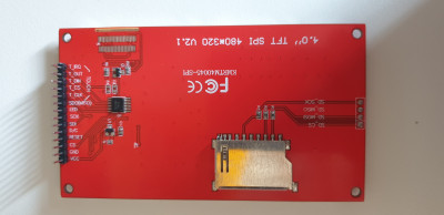

I am not able to mirror the screen. System: ATS25 with 4 inch screen, version 4.16 Air. This is what I changed:
screenMirror , 1 // =1 this true to screen mirroring
But it doesn't work, still stays upside down. What can i do now?

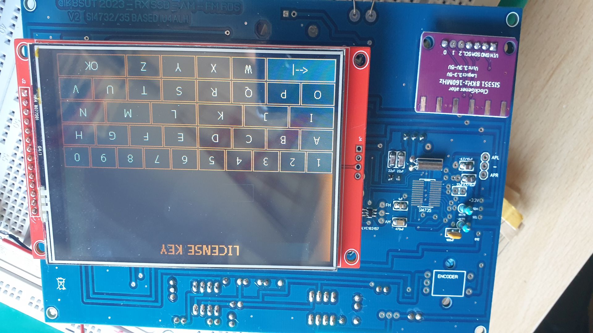

No nothing works!!! i will show u the Display, its the follow. so, if i start the sythem, i can see everything..BUT...the Touch its 90degr. rotated!! i try all the variables in the Settings.ini, but the only one thats works was the //screenDebug . aktivated and i can see the dot´s BUT....only 90degr. rotated!! in this case i cant put the Key in the Field..its not possible. we need a possibility to rotate the Touchkoordinates from beggining on. i mean bevor the system starts. AND the Koordinates must be stored permanently.
Otherwise, i will not hope, its a Problem with the Display. maybe i can make a little video and show u the Problem.
Greetings and 73, Klaus
Последний раз редактировалось ponti 25 сен 2023, 11:54, всего редактировалось 1 раз.
screenmirror 4 Zoll ATS25 not working
hello Mr.Binn´s. i send you the Video. Here also a Pic , you can see, from Beginning on the Screnn its upsidedown! It needs turned to 180degr.
The Touch its a other Problem. it need a calibration bevore the Firmware Start or a other Possibility.
73 de Klaus

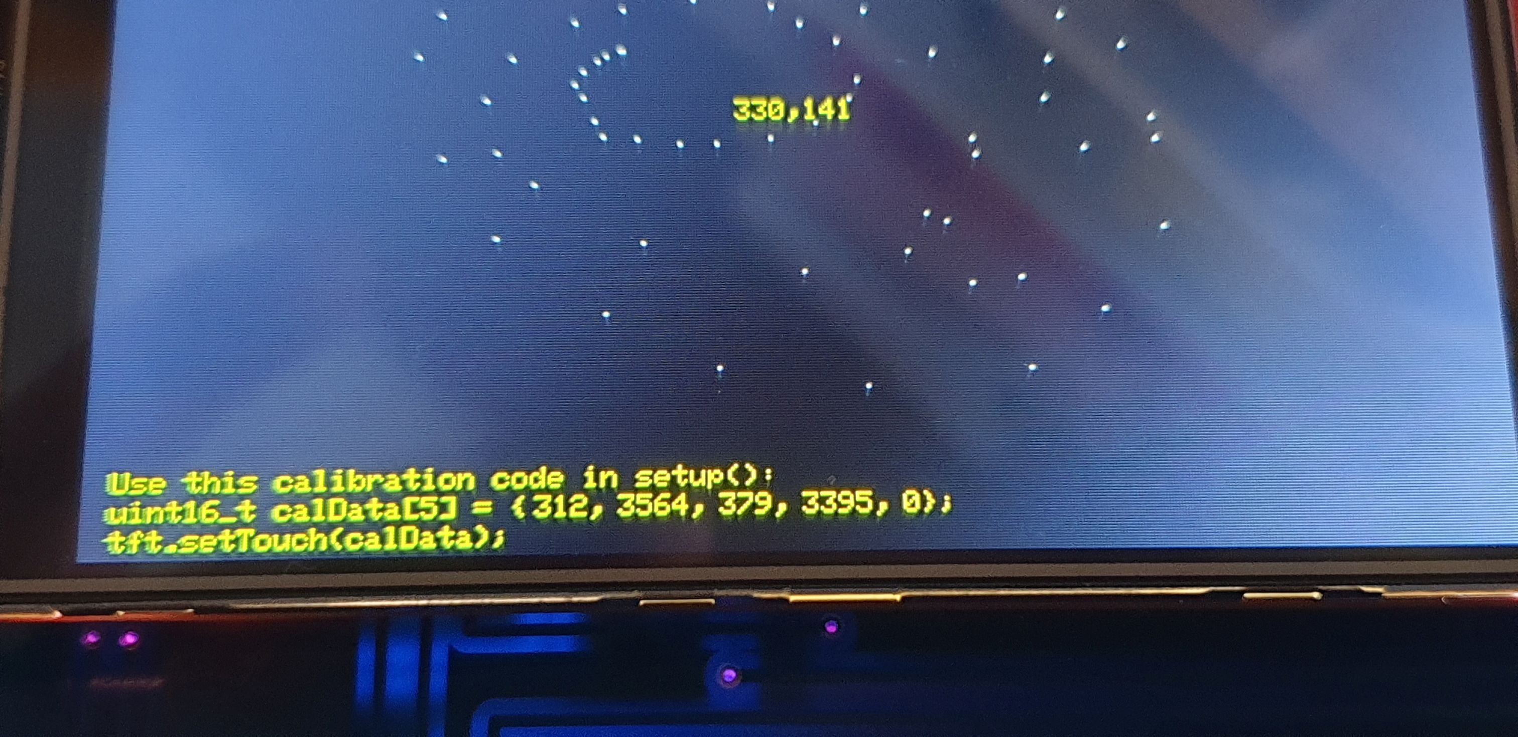

so what else have I done:
1. start the calibration program: AAA_Calibrazione_modled.ino
2. set Landscape
3. performed calibration
4. got the data: uint16_t calData[5] = {312, 3564, 379, 3395, 0 };
4.1. stored in a File named: /TouchCalData3
5. with this the orientation and the touch is ok
6. load the H.Radio 4.16AIR
7. everything as always, the display upside down and the touch does not work properly
it would be important to know now
what display orientation is done in your software at the start and could it be made selectable?
where could you enter this CAL DATA? or maybe the H.Radio program can use the Cal-file which is stored in the ESP32?
Greetings Klaus
