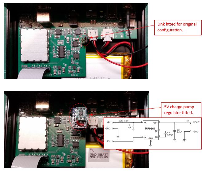

I used a similar charge pump, MP9361 which was £0.71 in the the UK.
I tested FT8 and RTTY decoding down to a DVM measured battery voltage of 2.8V and everything seems fine, the charge pump was still driving 5V to the DIGI decoder circuits.
On the downside, I did notice some noise at the switching frequency (as expected) which ranges from 1.2MHz to 1.4MHz (fundamental) and the dominant harmonics.
I did the modification in such a way that it can be set to operate in the original configuration without the charge pump regulator.
Note:
When the battery voltage falls below the drop out voltage of the LDO regulators, the 3V3 outputs will be unregulated. This causes some flickering on the display backlight, particularly if WIFI is enabled.

G8PTN писал(а): 13 фев 2024, 20:51 When the battery voltage falls below the drop out voltage of the LDO regulators, the 3V3 outputs will be unregulated. This causes some flickering on the display backlight, particularly if WIFI is enabled.
To avoid this, you first need to increase the battery voltage using a powerful booster to 5 volts, and then get 3.3 volts using the AMS1117 regulator. How is this done in the ATS25 max-Decoder and max-Decoder II receivers

Yes, I realise that is what is done in the Max Decoder.
However, even will filtering and linear regulators with high PSRR, there is inevitably going to be a bit more noise (conducted and radiated) than without the boost converter. The overall power efficiency is going to be around 60% and probably the reason for the increased battery capacity.
I think there are pros and cons with both methods.
