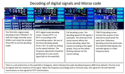

Hi Mika,
- For FT8 decoding you need to make sure that the clock on the ATS25 is synchronised.
The clock is automatically set when you are connected to a WIFI network with an Internet connection.
- For CW and RTTY you need to align the signal with the 800 Hz marker (red vertical line) on the waterfall.
(see attached)
The volume level may also need to be adjusted. This sets the input level to the decoder circuit.
(see attached)
