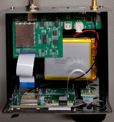

radi0 писал(а): 17 фев 2024, 09:00 wonder about these voltage problems, and to avoid installing a boost circuit if the simplest thing would not be to change the original 3000 mAh battery with one of 6000 or even 10000 mAh
The problem is not so much the capacity (mAh), but the voltage. The nominal voltage is 3.7V, fully charged 4.2V and discharged 3V.
The components (ICs) in the Digi Decoder circuit are specified for nominal 5V operation. In practice they work below this voltage, but are not guaranteed. Increasing the battery capacity may help to increase the time before a low voltage problem occurs.
The battery you have shown would not fit in the ATS25-AMP, but other higher capacity variants should fit. Check the battery thickness, since it sits under the PCB.
The enclosure is approximately 112 x 102 x 48mm.
Note: If the battery is changed, you will need one with the protection circuit, or add it separately. There is no protection on the ATS25 AMP board.

Сообщение radi0 »
Yes, the aim of adding a 10,000 mAh battery is simply to bring the voltage down as slowly as possible to a critical voltage for the decoding chip.
The problem with a 5 v voltage booster is the parasites it produces, we must not forget that he installed an LNA in the rx. I think this is why the manufacturer of the asp25 AMP did not install the 5 v boost.

radi0 писал(а): 17 фев 2024, 12:55 The problem with a 5 v voltage booster is the parasites it produces, we must not forget that he installed an LNA in the rx. I think this is why the manufacturer of the asp25 AMP did not install the 5 v boost.
Yes, all understood.
The modification that I made was just to add a low power charge-pump to the Digi Decode circuitry. This is what is used on the ATS120D decoder board. There will still be some conducted noise feedback to the battery supply and radiated emissions, so it is not ideal.
The logic level for the CW/RTTY decoder signal (without the 5V boost) can be fixed by changing the arrangement of the pull-up resistor on the LM567 output (see previous messages).
With the USB cable plugged in, the battery voltage will get close to 4.2V, but the charger chip is switched mode (for efficiency), so that will also create noise. Charging will not terminate when the receiver is switched on because the current does not drop to the cut-off threshold.
The ESP32 is marked "ESP32-WROOM-32U". The nominal operating voltage is 3V3 and the specified range is 2.7V to 3.6V.
As previously stated, the ATS25-AMP will generally operate correctly, so for the cost of the receiver and performance you will get, it’s probably best just leaving it as is.
