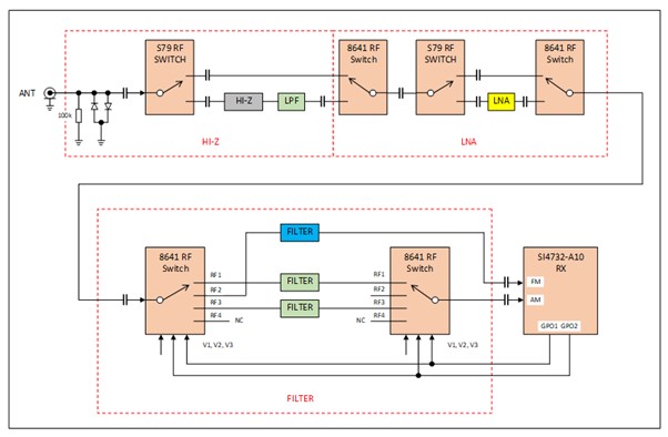

As a user of the ATS25-AMP, please see a summary of my findings below.
On inspection of the PCB, an inferred simplified block diagram of the additional RF circuitry is shown attached. These functions have not been characterized.
- Impedance selection: 50Ω, HI-Z.
- Filtering: Low-Pass and Band-Pass.
- Low Noise Amplifier: LNA.
Note: There appears to be an HF low-pass filter (i.e. sub 30MHz) in the HI-Z path and therefore selecting HI-Z whilst receiving VHF (WFM) is not appropriate.

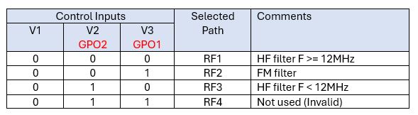

I have updated my ATS25 AMP to V4.2 AIR beta.
The installation was fine and "ATS25 AMP" was selected in the setup on the receiver.
Everything appears to be working correctly, but I have noticed a minor issue.
Switching between various options seems to result in the wrong values for the SI4732 GPO1 and GP02 signals.
Example 1:
If a “HAM” band is selected, switching to a broadcast band via the “BAND” option (or entering a frequency outside the ham bands) causes the GPO1 control signal to be set to Logic ‘1’. This effectively selects the FM filter RF path and results in no signal to the AM input of the SI4732.
Switching back to a “HAM” band, the GPO1 signal remains at logic ‘1’. If a different “HAM” band is then selected requiring GP02 to change, the GP01 signal is then set back to logic ‘0’ which is the correct state.
It seems that any similar selection causes the same invalid setting of GPO1.
Ham band > Broadcast band
Broadcast band > Ham Band
Ham band > CB
Etc…
Apart the case when switching to “CB” it is possible to work-around the issue as described above.
A basic truth table for correct operation is shown below. 73, Dave
Example 1:
Ham band > CB
Etc…
