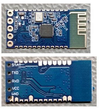

HI,
Something like the very cheap JDY-31 Bluetooth module connected to the serial data pins of the ESP32 should work.
I am not sure if the CH340 output would need to be disconnected, or if it is high impedance when not driving.

ponti
yes, somthing like this..if you have Problems with USB Cummunication after Install the BT Module, put a Diode in the RX Line, Kathode to the BT. TX Line its fine.
But in my case it works without.
