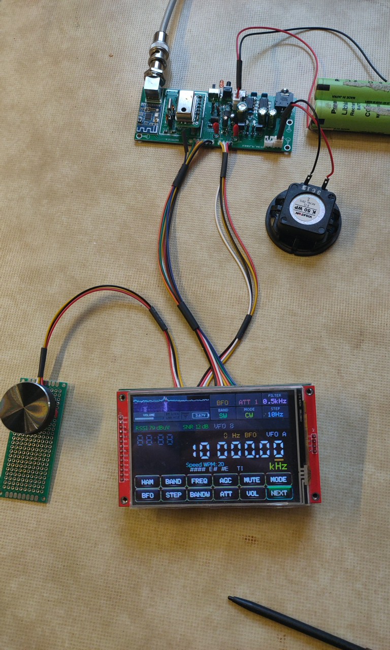

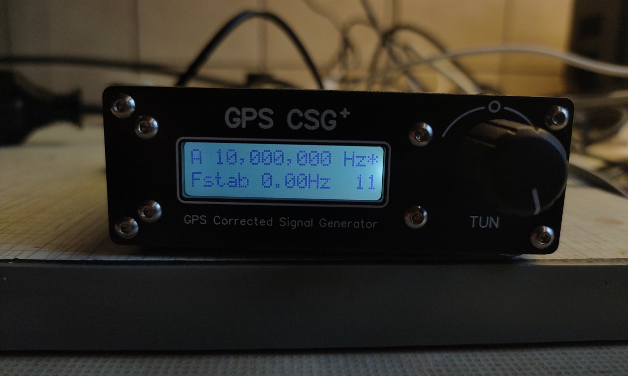

Now I wanted to precisely adjust the frequency of the Si473x's crystal oscillator using a GPS-controlled oscillator. I set 10,000 MHz and found the CW mode very useful for adjustment. I noticed a different center frequency between CW and CWR.
Finally I had checked the setting on different frequencies. However, larger and smaller deviations in the center frequency were found. In some cases there is a deviation of up to approx. 400 Hz. I therefore suspect that an exact setting of 32.768 KHz makes little sense and a watch quartz would be completely sufficient.
I tested this with the ATS25x2 (converted to a decoder) and an RX that I built myself according to V9.

Gunka, Your experiments are interesting, but could you make a short video of how you check the frequency in CW and CWR

I have tested with GPS controlled Oscillator.
My Receiver is the V9. Software 4.16 Air.
Video here is unfortunately not possible.
So I will try to send small videos to your Mail address...
