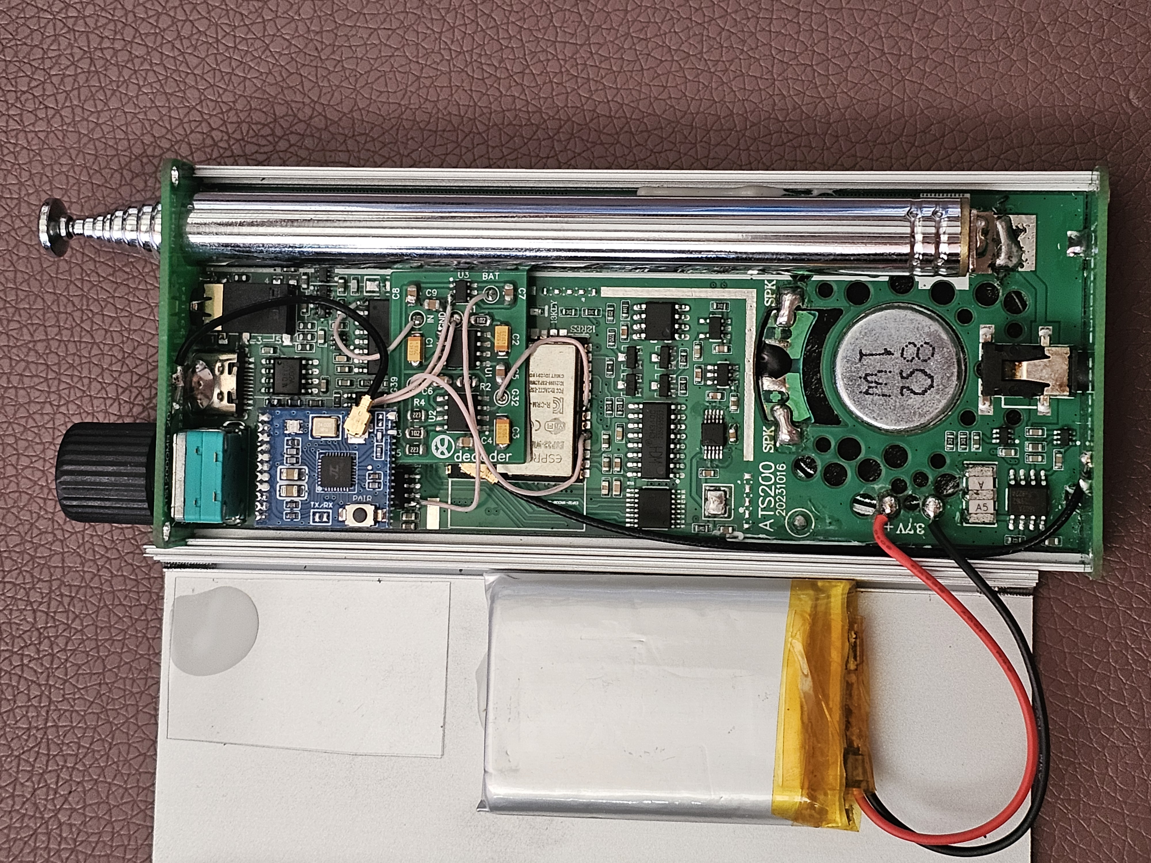

NEED SUPPORT
hi hope you can help
i have ats200 got from amazon
just updated with key to 4.2 great quick responce from admin
all ok but no digi and i cant get any wif it show very poor signal
is it possibe the seller on amazon gave me amodel with no decoder board and if so where can i get a decoder from
many thanks for any help in advance
Anthony
Anthony
