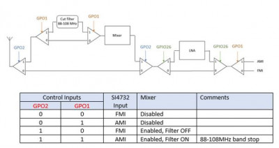

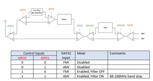

For interest, does the ATS25 Max Decoder II use GPO2 for its HF filter selection?
The generic diagram generated for the mixer arrangement implies the following truth table.
If like the ATS25-AMP, the ATS25 Max Decoder II uses GPO2 for its internal HF filters depending on frequency (i.e. <12MHz or >12MHz), how can this work with the mixer arrangement?

G8PTN писал(а): 03 май 2024, 13:02 If like the ATS25-AMP, the ATS25 Max Decoder II uses GPO2 for its internal HF filters depending on frequency (i.e. <12MHz or >12MHz), how can this work with the mixer arrangement?
This will not work automatically unless you come up with a different switching scheme for filters. The minimum that can be done is to switch manually to connect the mixer.
Binns писал(а): 03 май 2024, 13:11 This will not work automatically unless you come up with a different switching scheme for filters. The minimum that can be done is to switch manually to connect the mixer.
All understood. It just seems strange that GPO2 was chosen for the mixer control if it is already being used for filter selection on the ATS25-AMP and Max Decoder II. Obviously, it is possible to cut the GPO2 track that controls the filter selection and then use another ESP32 control signal or a separate hardware switch.
Сообщения: 434
Благодарил (а): 24 раза
Поблагодарили: 116 раз
G8PTN писал(а): 03 май 2024, 13:46 It just seems strange that GPO2 was chosen for the mixer control if it is already being used for filter selection on the ATS25-AMP and Max Decoder II.
GPO2 was previously used for a mixer in another model. The filters will be controlled using the PCF8575 port extender. Hardware developers do not always consult with firmware developers, but we try to minimize compatibility issues.

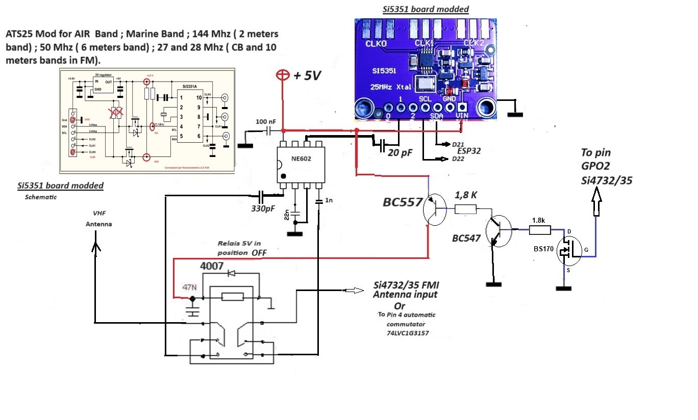

If a converter board is mounted on the ATS25 receivers or on a homemade "generic" one, it is possible that the receiver will no longer detect the Si4732/35 radio chip.
This problem arises from the load on the GPO2 pin which is carried out by the switching transistor (which drives the switching relay),
To solve this problem you need to add a Mosfet transistor as in the photo of the electrical circuit I attach.
