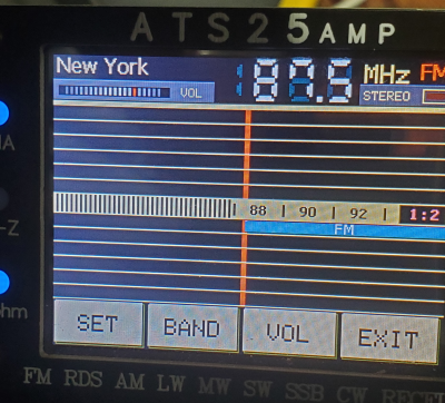

FM lower limit frequency in retro mode on ATS-25amp
Сообщение drelectron3 »
I set FM from 64MHZ in the SETUP Menu, but it still starts from 87.5MZ on the RETRO screen.

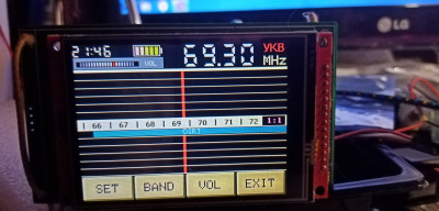

Turn on 64 MHz, , NEXT, search <<DN and that's it. That's how it worked for me.
Your screen is a VHF screen, not an FM screen. I can also display from 64MHz if it is VHF. The FM screen is probably from 87.5MHz.
drelectron3
Зарегистрирован: 09 ноя 2024, 03:10
IN VHF, the maximum freqencey is up to 87 MHZ INSTEAD.
I live in Japan.In Japan, the FM band must range from 70 MHz to 108 MHz.
