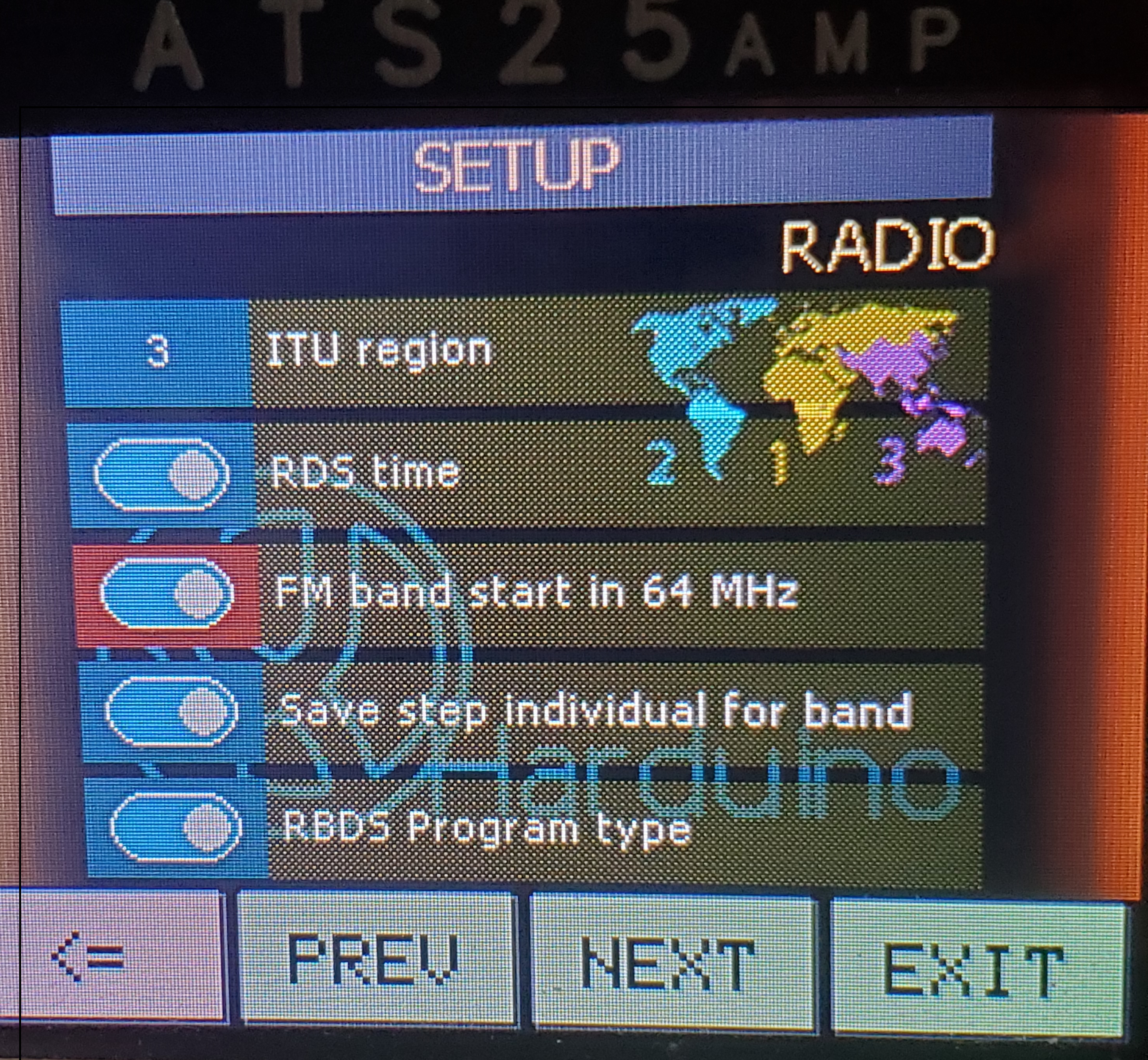

drelectron3, Enable the FM range from 64 MHz in the menu settings.

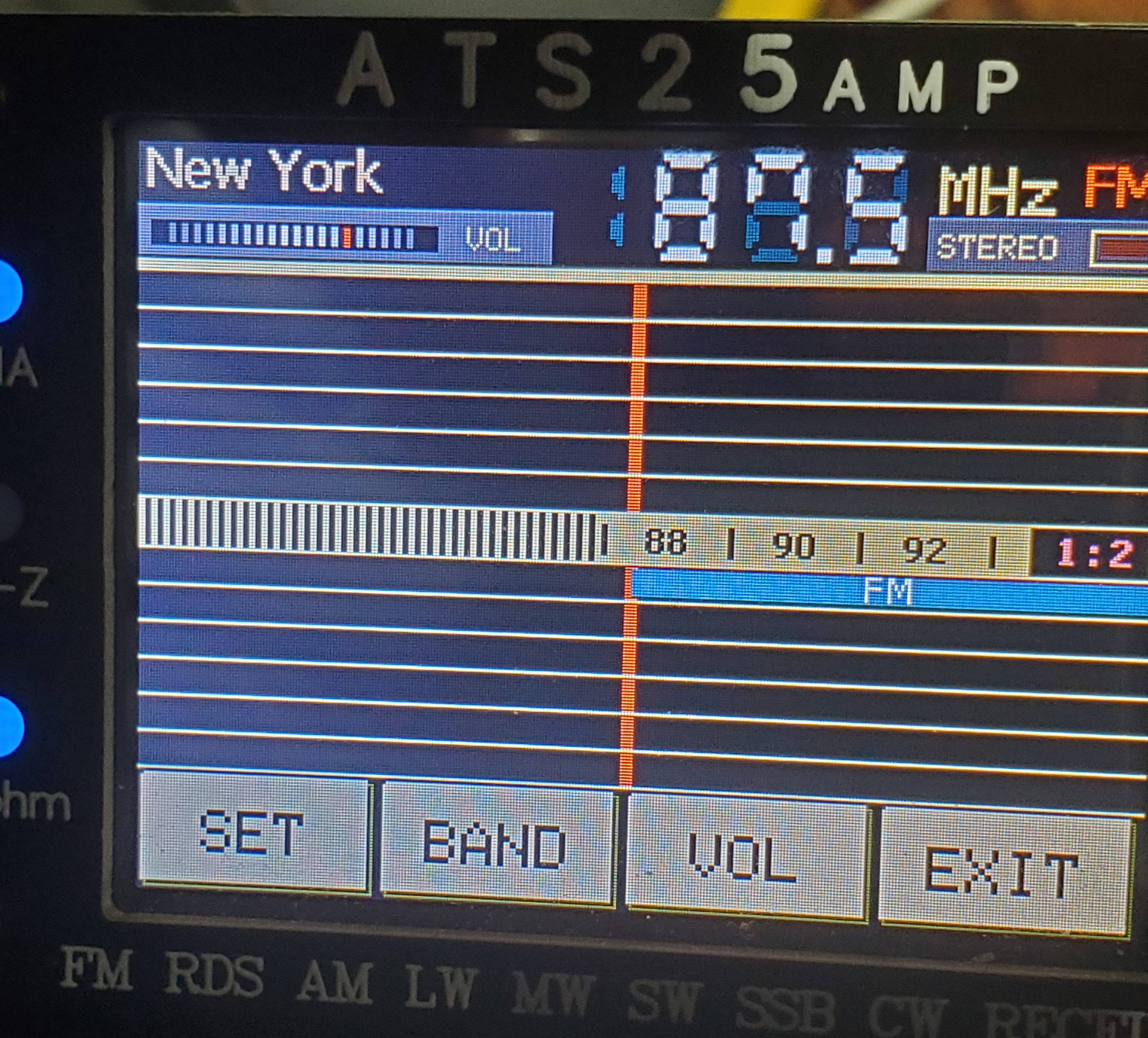

I set FM from 64MHZ in the SETUP Menu, but it still starts from 87.5MZ on the RETRO screen.
![Изображение]()

Turn on 64 MHz, , NEXT, search <<DN and that's it. That's how it worked for me.

Your screen is a VHF screen, not an FM screen. I can also display from 64MHz if it is VHF. The FM screen is probably from 87.5MHz.
