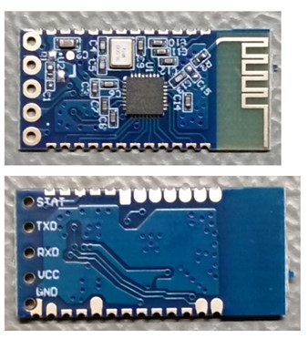

I have installed a digital BT adapter and use it to transmit e.g. FT8 via Bluetooth to a smartphone and tablet.
Data transfer via A-Explorer is also possible.
It works perfectly.

ponti писал(а): ↑05 мар 2024, 23:09 I have installed a digital BT adapter and use it to transmit e.g. FT8 via Bluetooth to a smartphone and tablet.
Please tell us in more detail how you do it

HI,
Something like the very cheap JDY-31 Bluetooth module connected to the serial data pins of the ESP32 should work.
I am not sure if the CH340 output would need to be disconnected, or if it is high impedance when not driving.

yes, somthing like this..if you have Problems with USB Cummunication after Install the BT Module, put a Diode in the RX Line, Kathode to the BT. TX Line its fine.
But in my case it works without.
